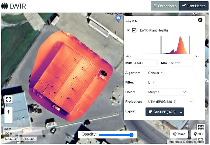

Thermal Support
ODM has support for radiometric calibration of thermal data, which is able to generate temperature orthophotos from long-wave infrared (LWIR) cameras. LWIR images can be processed alone or as part of a multispectral dataset.
Hardware
While we aim to support as many cameras as possible, thermal support has been developed using the following cameras, so they will work better:
Other cameras might also work. You can help us expand this list by sharing datasets captured with other cameras.
Usage
Process the images using the --radiometric-calibration camera parameter to enable radiometric calibration.
