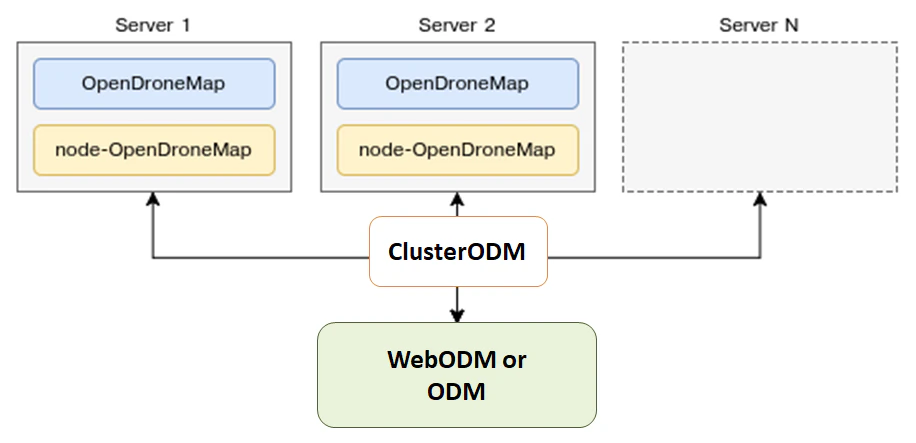

Distributed Split-Merge
ODM can also automatically distribute the processing of each submodel to multiple machines via NodeODM nodes, orchestrated via ClusterODM.

The first step is start ClusterODM
docker run -ti -p 3001:3000 -p 8080:8080 opendronemap/clusterodm
Then on each machine you want to use for processing, launch a NodeODM instance via
docker run -ti -p 3000:3000 opendronemap/nodeodm
Connect via telnet to ClusterODM and add the IP addresses/port of the machines running NodeODM
$ telnet <cluster-odm-ip> 8080
Connected to <cluster-odm-ip>.
Escape character is '^]'.
# node add <node-odm-ip-1> 3000
# node add <node-odm-ip-2> 3000
# node list
1) <node-odm-ip-1>:3000 [online] [0/2] <version 1.5.1>
2) <node-odm-ip-2>:3000 [online] [0/2] <version 1.5.1>
Make sure you are running version 1.5.1 or higher of the NodeODM API.
At this point, simply use the --sm-cluster option to enable distributed split-merge
docker run -ti --rm -v /my/project:/datasets/code opendronemap/odm --project-path /datasets --split 800 --split-overlap 120 --sm-cluster http://<cluster-odm-ip>:3001
