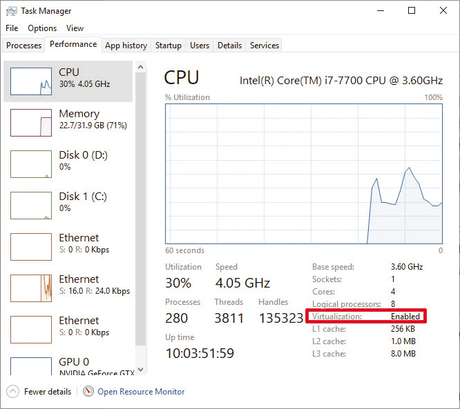

Step 1. Check Virtualization Support
Docker requires a feature from your CPU called virtualization, which allows it to run virtual machines (VMs). Make sure you have it enabled! Sometimes this is disabled. To check, on Windows 8 or higher you can open the Task Manager (press CTRL+SHIFT+ESC) and switch to the Performance tab.
Image of checking virtualization in Windows 8 or higher
Virtualization should be enabled

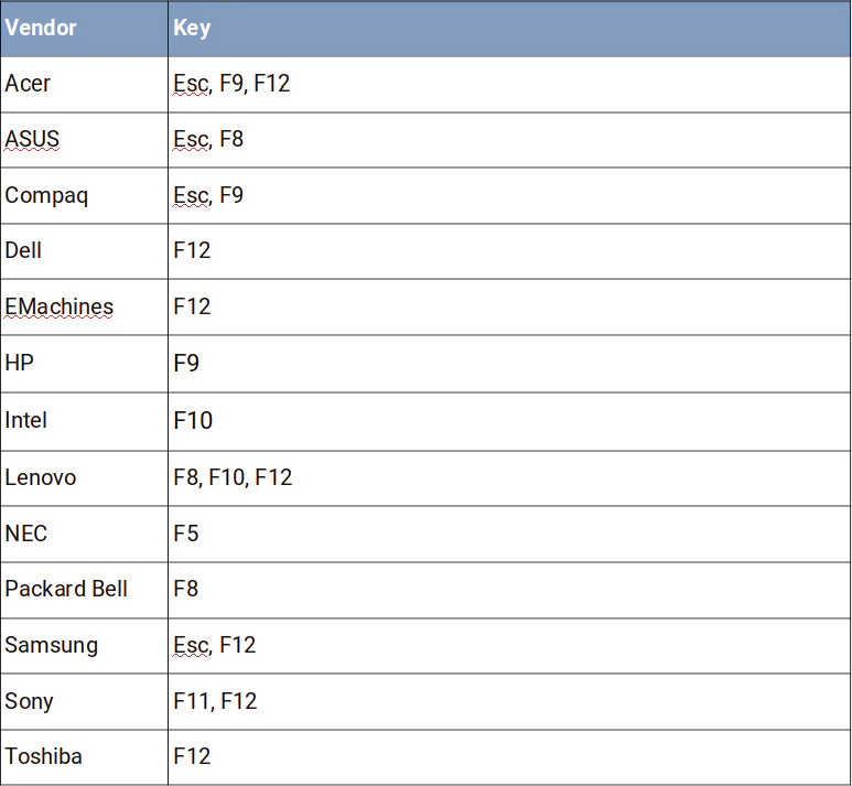

If virtualization is disabled, you’ll need to enable it. The procedure unfortunately is a bit different for each computer model, so the best way to do this is to look up on a search engine “how to enable vtx for <type your computer model here>”. Often times it’s a matter of restarting the computer, immediately pressing F2 or F12 during startup, navigating the boot menu and changing the settings to enable virtualization (often called “VT-X”).
Table of different bios keys
Common keys to press at computer startup to access the boot menu for various PC vendors

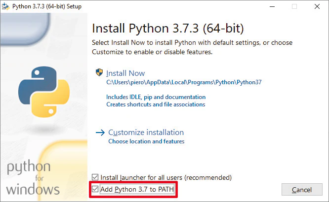

Step 2. Install Requirements
First, you’ll need to install:
For Python 3, make sure you check Add Python 3.x to PATH during the installation.
Screenshot of Python3 installation process
Don’t forget to add the Python executable to your PATH (so that you can run commands with it)

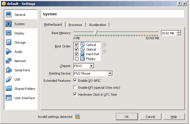

Step 3. Check Memory and CPU Allocation
Docker on Windows works by running a VM in the background (think of a VM as a “computer emulator”). This VM has a certain amount of memory allocated and WebODM can only use as much memory as it’s allocated.
If you installed Docker Toolbox (see below if you installed Docker for Windows instead):
  1. Open the VirtualBox Manager application
  2. Right click the default VM and press Close (ACPI Shutdown) to stop the machine
  3. Right click the default VM and press Settings...
  4. Move the Base Memory slider from the System panel and allocate 60-70% of all available memory, optionally adding 50% of the available processors from the Processor tab also
Screenshot of VirtualBox Settings
VirtualBox default VM settings
Then press OK, right click the default VM and press Start.

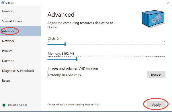

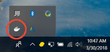

If you installed Docker for Windows instead:
  1. Look in the system tray and right click the “white whale” icon.
  2. From the menu, press Settings...
  3. From the panel, click Advanced and use the sliders to allocate 60-70% of available memory and use half of all available CPUs.
  4. Press Apply.
Screenshot of Docker Icon
Step 1 Docker icon
Screenshot of Docker Settings
Step 3 & 4 Docker settings

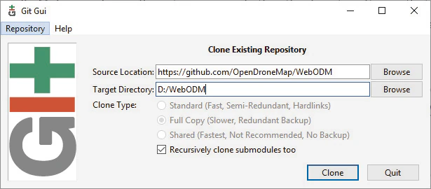

Step 4. Download WebODM
Open the Git Gui program that comes installed with Git. From there:
  • When Git Gui opens, click 'Clone Existing Repository' option
  • In Source Location type: https://github.com/OpenDroneMap/WebODM
  • In Target Directory click browse and navigate to a folder of your choosing (create one if necessary)
  • Press Clone
Screenshot of Git Gui
Git Gui

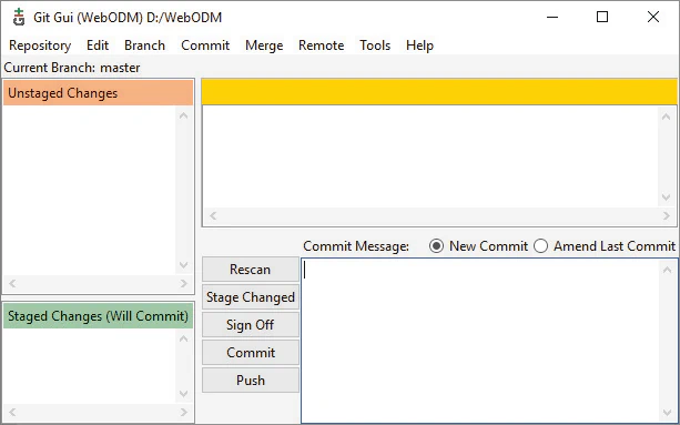

If the download succeeded, you should now see this window:
Screenshot of Git Gui after successful download
Git Gui after successful download (clone)
Go to the Repository menu, then click Create Desktop Icon. This will allow you to come back to this application easily in the future.

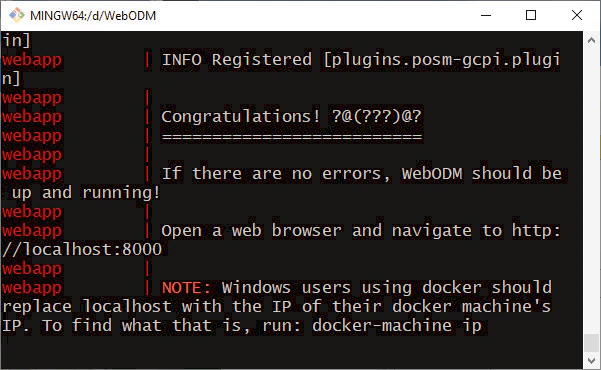

Step 4. Launch WebODM
From Git Gui, go to the Repository menu, then click Git Bash. From the command line terminal type:
$ ./webodm.sh start &
Several components will download to your machine at this point, including WebODM, NodeODM and ODM. After the download you should be greeted by the following screen:
Screenshot of after successfully downloading WebODM
Console output after starting WebODM for the first time
  • If you are using Docker for Windows, open a web browser to http://localhost:8000
  • If you are using Docker Toolbox, find the IP address to connect to by typing:
$ docker-machine ip
You should get a result like the following:
192.168.1.100
Then connect to http://192.168.1.100:8000 (replacing the IP address with the proper one).

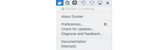

After installing docker you should find an icon that looks like a whale in the task bar.
Screenshot of Docker whale
Docker app running

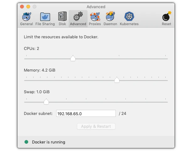

Docker on macOS works by running a VM in the background (think of it as a “computer emulator”). This VM has a certain amount of memory allocated and WebODM can only use as much memory as it’s allocated.
  1. Right click the whale icon from the task bar and click Preferences...
  2. Select the Advanced tab
  3. Adjust the CPUs slider to use half of all available CPUs and the memory to use 60-70% of all available memory
  4. Press Apply & Restart
Screenshot of Docker advanced settings

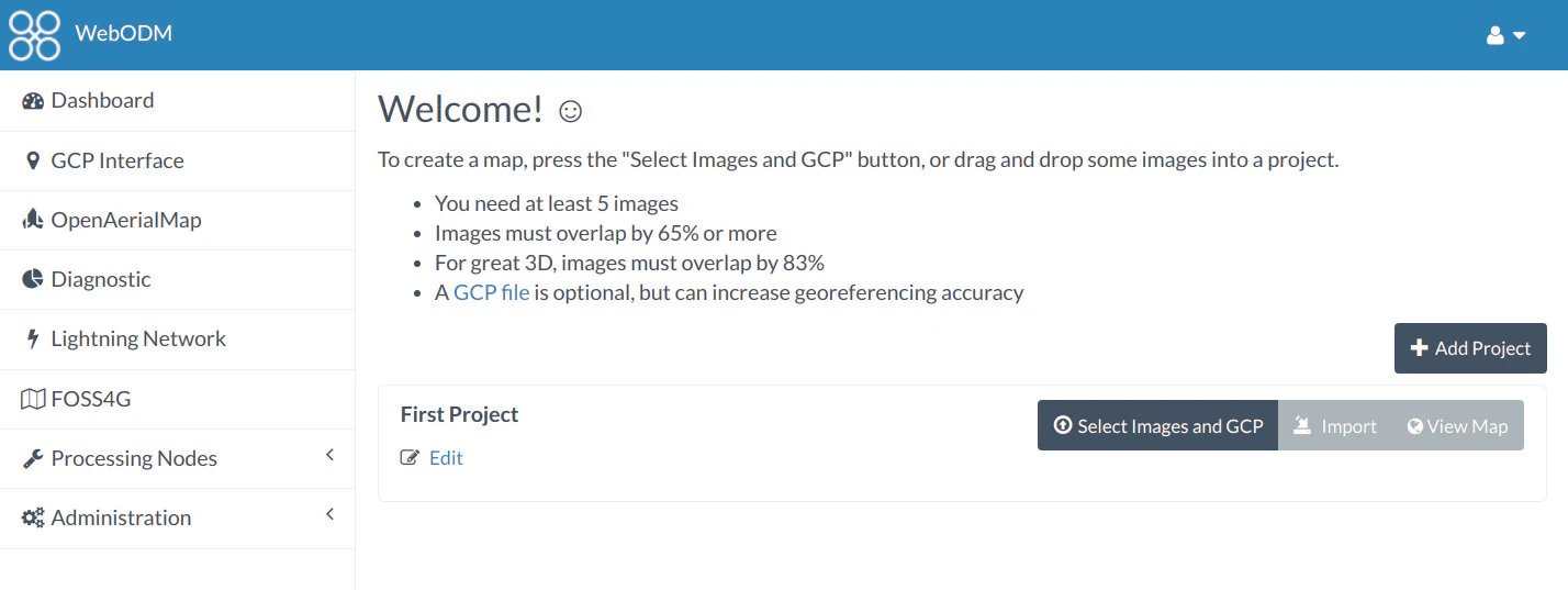

After starting the containers using 3a. or 3b. you can open WebODM in the browser. This will greet you with a welcome message and will ask to create the first user. Take some time to familiarize yourself with the web interface and explore its various menus.
Screenshot of WebODM Dashboard
WebODM Dashboard
Notice that under the Processing Nodes menu there’s a "node-odm-1" node already configured for you to use. This is a NodeODM node and has been created automatically by WebODM. This node is running on the same machine as WebODM.
If you’ve made it this far, congratulations! Now it’s time to start processing some data.
