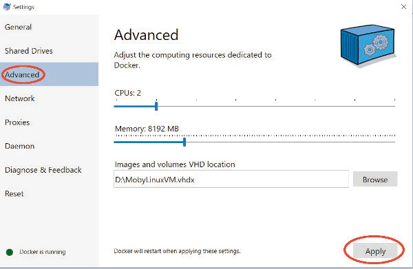

Hardware Recommendations

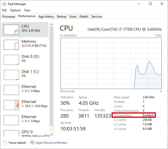

The bare minimum requirements for running the software are:
  • 64bit CPU manufactured on or after 2010
  • 20 GB of disk space
  • 4 GB RAM
No more than 100-200 images can be processed with the above specifications (the software will run out of memory). Recommended requirements are:
  • Latest Generation CPU
  • 100 GB of disk space
  • 16 GB RAM
The above will allow the processing of a few hundred images with minimal issues. A CPU with more cores will allow for faster processing, while a graphics card (GPU) currently has no impact on performance. For processing more images, add more disk space and RAM linearly to the number of images you need to process.
