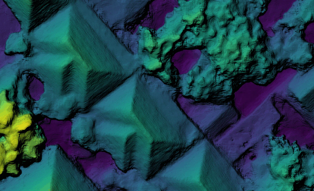

Animated gif comparing two separately processed, but aligned digital surface models.

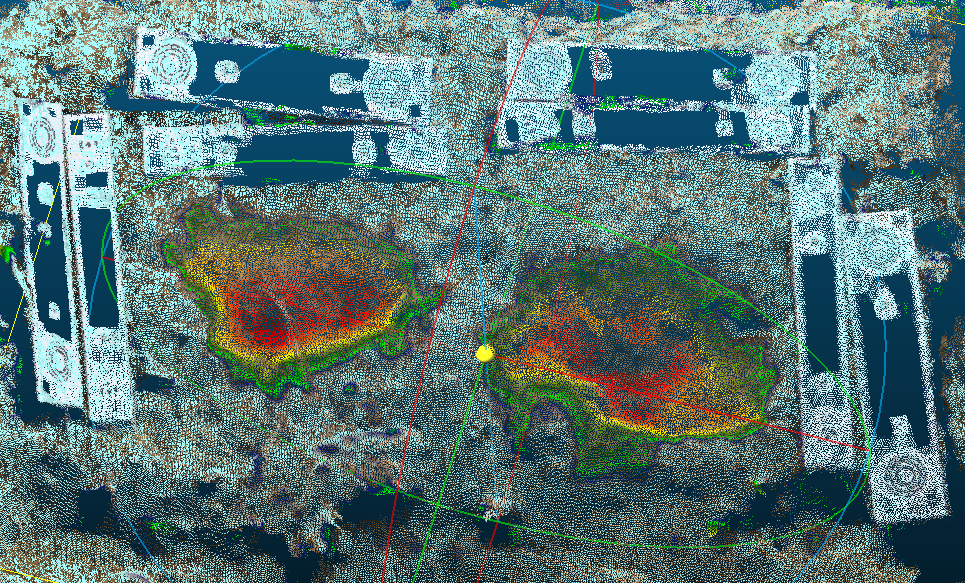

You can then use CloudCompare to compute distance between the datasets/0_before/odm_filterpoints/point_cloud.ply
and the datasets/1_after/odm_filterpoints point_cloud.ply
and obtain this image showing the difference between the two 3D surfaces. Here, two soil samples were excavated as can be seen on the image below.
